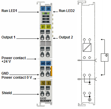

Fig.4: LEDs and connection EL4102LEDs

RUN |
green |
These LEDs indicate the terminal's operating state: | |
off |
State of the EtherCAT State Machine: INIT = initialization of the terminal or BOOTSTRAP = function for firmware updates of the terminal | ||
flashing |
State of the EtherCAT State Machine: PREOP = function for mailbox communication and different standard-settings set | ||
single flash |
State of the EtherCAT State Machine: SAFEOP = verification of the Sync Manager channels and the distributed clocks. | ||
on |
State of the EtherCAT State Machine: OP = normal operating state; mailbox and process data communication is possible | ||
If several RUN LEDs are present, all of them have the same function.
Connection
Terminal point | Comment | Internally connected with connector | Max. current carrying capacity *) | |
Designation | No. | |||
Output 1 | 1 | Output 1 | - | Specified by output power |
- | 2 | Without function | - | - |
GND | 3 | Signal ground for Output 1 | 7 | 40 mA |
Shield | 4 | Shield (FE) | 8, mounting rail | 100 mA **) |
Output 2 | 5 | Output 2 | - | Specified by output power |
- | 6 | Without function | - | - |
GND | 7 | Signal ground for Output 2 | 3 | 40 mA |
Shield | 8 | Shield (FE) | 4, mounting rail | 100 mA **) |
*) Constant and peak value
**) Shield lines should be de-energized!
![]() | Terminal points „Without function“ Terminal points "without function" may be equipped for production reasons, they must not be connected to conductors. |
