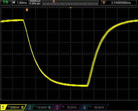

General information on commissioning the EL407x 2:Fig.147: EL4078 with 500 µs EtherCAT cycle time, output jitter according to theory ±0.5 cycles

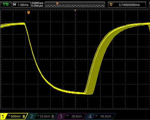

General information on commissioning the EL407x 3:Fig.148: EL4078 with 100 µs EtherCAT cycle time, output jitter > 1 ms
