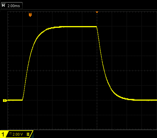

Output behavior, rise time
You can expect approx. 3 ms for 0->90% and approx. 6 ms for 0->100%
Instructions for use 1:Fig.153: Rise time representation
