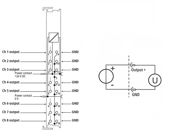

Voltage output 0...10 V / -10...+10 V
EL4078 2:Fig.12: Connection example EL4078, voltage output, 2-wire

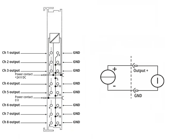

Current output -20 / 0 / +4…+20 mA
EL4078 3:Fig.13: Connection example EL4078, current output, 2-wire
