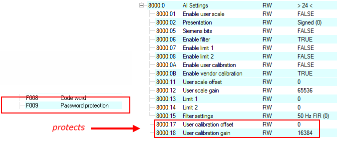

Password protection for user data
Some user data are protected against unwanted or inadvertent writing by an additional password to be entered in CoE 0xF009:
  • CoE write accesses by the user, PLC or startup entries in Single or CompleteAccess mode
  • Overwrite the values by RestoreDefaultParameter Access to 0x80n0 (or 0x80nD, if available)
Setpoint processing, user/vendor calibration 1:Fig.186: Password protection for the 0x8000:17 and 0x8000:18 entries (example)
Use of CoE 0xF009
  • Entering 0x12345678 enables the password protection → Object shows "1" (enabled)
    Protected objects can now no longer be changed, no error message occurs during a write access!
  • Entering 0x11223344 disables password protection → Object displays "0" (disabled)
Password protection takes effect with the following AI settings:
