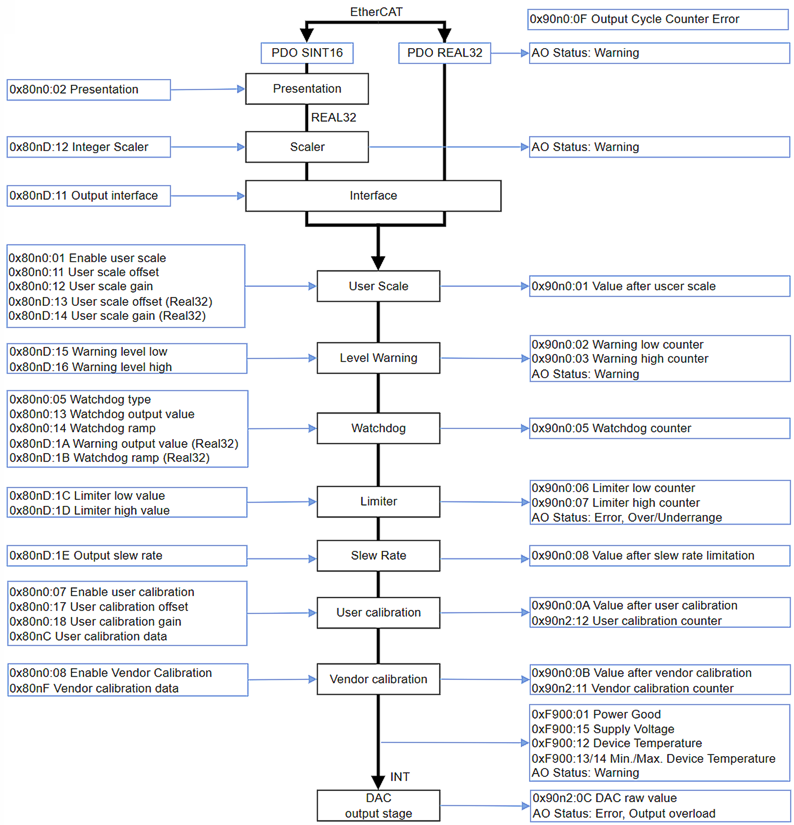

Data flow AO (Analog Output)
The signal acquisition and data processing of the analog output of this product is as follows:
Fig.155: Data flow of the analog outputData flow diagram legend | |
Left column | Changeable parameters (CoE settings or status PDO) that influence processing |
Middle column | Functional units |
Right column | Intermediate values and results, displayed in the CoE or status PDO |
