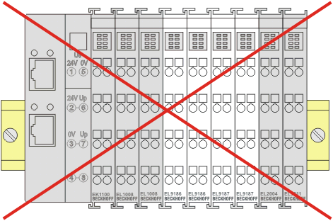

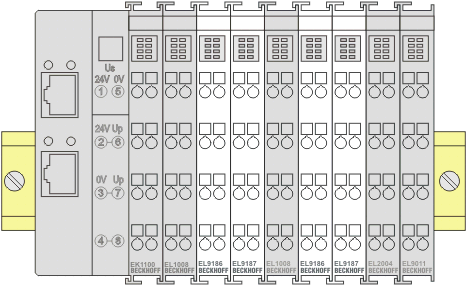

![]() | Hint for positioning of passive terminals in the bus terminal block EtherCAT Terminals (ELxxxx / ESxxxx), which do not take an active part in data transfer within the bus terminal block are so called passive terminals. The passive terminals have no current consumption out of the E-Bus. |
Examples for positioning of passive terminals (highlighted)
Fig.26: Correct positioning
Fig.27: Incorrect positioning
