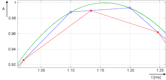

For example, a sinusoidal signal decimated with 50/44.1 = 1/0.882 can be represented as follows:
- Green: corresponds to original analog signal (input), approx. 432 Hz
- Blue (O): corresponds to sampling of the EL3751/ ELM3xxx with fmax of 10,000 sps; a sampling interval of 100 µs
- Red (X): corresponds to signal converted by PLC to 8820 sps (factor 0.882) and thus a time interval of approx. 113.37.. µs

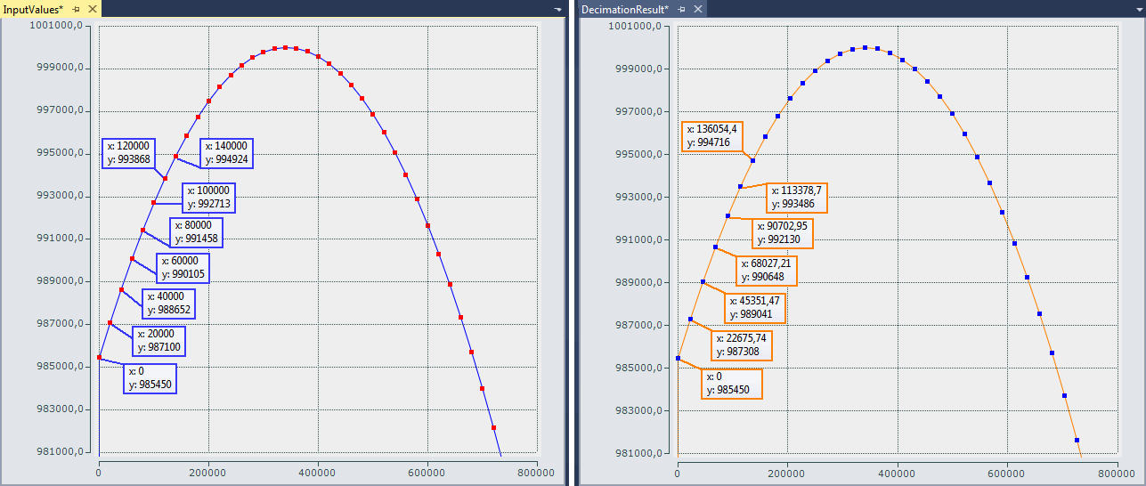

For an illustrative representation, the ScopeView recording was started first and then the program, which limits the decimated values to one second:
IF nOVS_CycleCount = 1000000000 THEN ; bEnable := FALSE;// Stop after 1s just for recording ELSE...This line can, of course, be commented out for further adjustments:
//bEnable := FALSE;// Stop after 1s just for recording

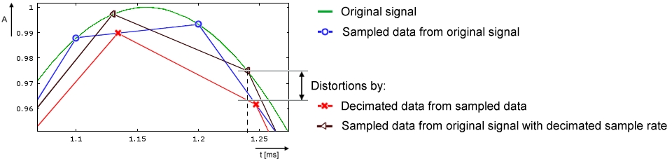

- the target sampling rate ftarget should be close to the sample rate fmax, so that it is possible to evaluate a time interval between two decimated values. The desired decimation may require further parameters such as task cycle time, oversampling factor etc. to be adjusted both in the configuration and as variable initialization in the sample program (see figure "Process of variable decimation of the sample program", which illustrates the functionality of the program code).
- Basically, the conversion process in this sample program causes distortions in the result in relation to the original signal shape when decimating with fractional rational factors (see signal curve). In concrete terms, deviations from the original signal curve only occur in those sections where the time derivative value (the slope) is not constant. For example, input values of a sine signal in the non-linear sections are distorted by the interpolation performed in the program:

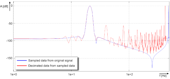

In the frequency spectrum, for example by a calculation with 20 Hz sinus signal, sampled with 500 sps and decimated to 441 sps, this is illustrated as follows:
- If no low-pass filtering corresponding to ftarget is performed on the data stream, aliasing effects will occur! It is therefore advisable to perform low-pass filtering in the PLC, e.g. with the TC3 Controller Toolbox or the TC3 Filter Library, before the conversion/decimation is performed. Suitable filters can easily be created with the TE1310 FilterDesigner. For more information, see www.beckhoff.com:
Automation → TwinCAT 3 → TE1xxx | TC3 Engineering → TE1310 | TC3 Filter Designer
Alternatively, the filters available in the EL3751/ ELM3xxx can, of course, be set to the suitable low-pass frequency; the TwinCAT Filter Designer is also helpful for this. - Entries of decimation factors within the program (nDecimationValue) should have a value > 1. The program code supports down sampling only.
E.g.: If a terminal such as ELM3602-0002 (2-channel IEPE evaluation) provides a data stream with oversampling of 50 ksps at 100 µs cycle time, this sample code can decimate to 44.1 ksps. In the sample program, the cycle ticks in the task configuration should be changed from 5 to 1 and the corresponding program variable nTaskCycle_ns from 500000 to 100000. See the following image section of ScopeView XY:
Fig.55: Decimation from 20 µs (left) to 22.675.. µs (right) with ELM3602The decimation factor is given by entering the value "50/44.1" for nDecimationValue in the sample. If this sample is used for the EL3751 with 500 µs cycle time and 5x oversampling, the sampling interval of 100 µs, which originates from the EL3751, is converted to approx. 113.378.. µs. This sample is designed accordingly.
