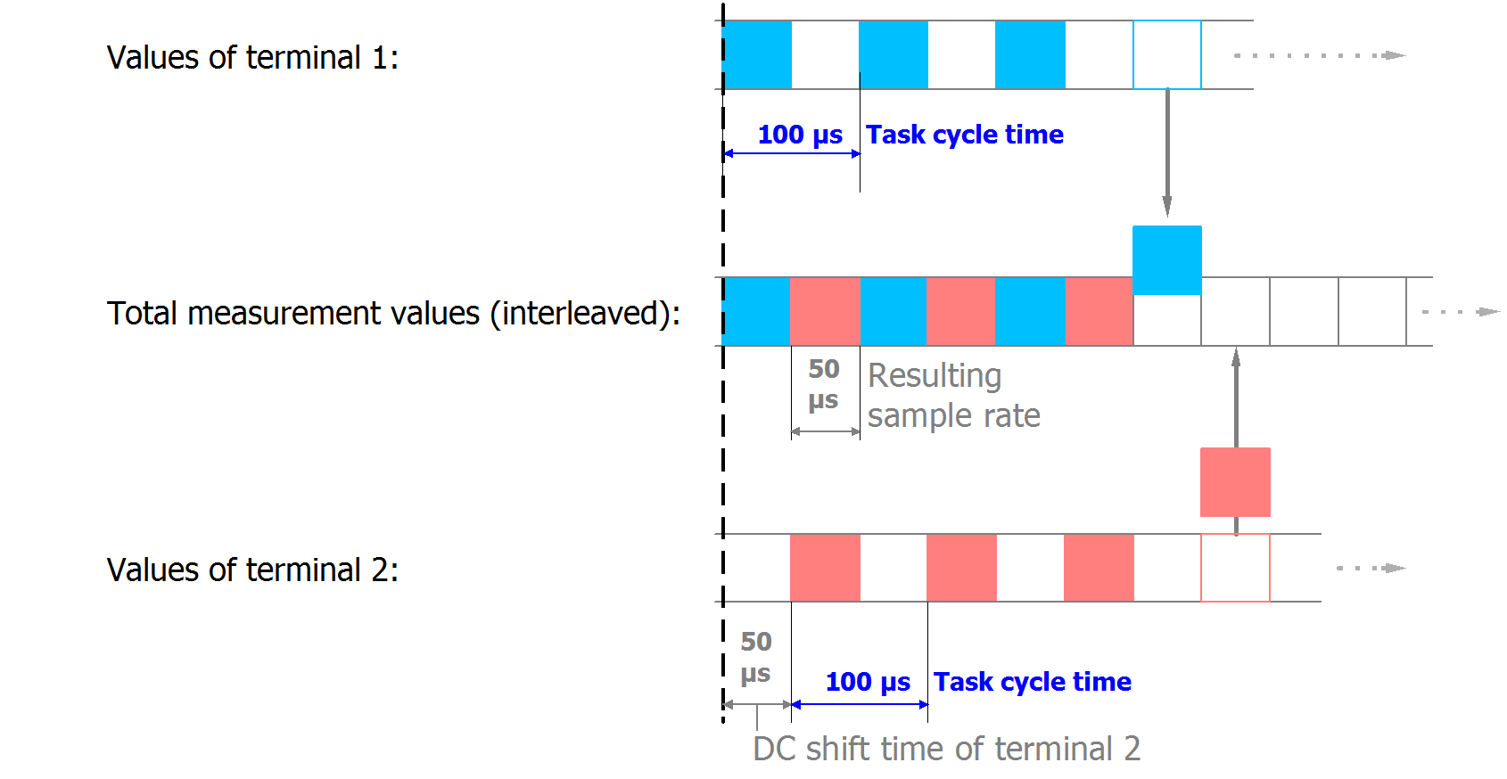

The second way is described in this sample: Use of two EL3751 EtherCAT Terminals, each with a maximum sampling rate of 10 kSps (and thus a conversion time of 100 µs in this case, cf. Further documentation for I/O components with analog in and outputs, chapter “Temporal aspects of analog/digital or digital/analog conversion”). Due to their parallel connection, both terminals are fed the same signal simultaneously and are configured by Distributed Clocks in such a way that they sample not at the same time, but offset by half the conversion time (in this case: 50 µs). If the two measured data streams are now combined alternately in the controller, i.e. "interlaced", the result is a net measured data stream of 20 ksps.

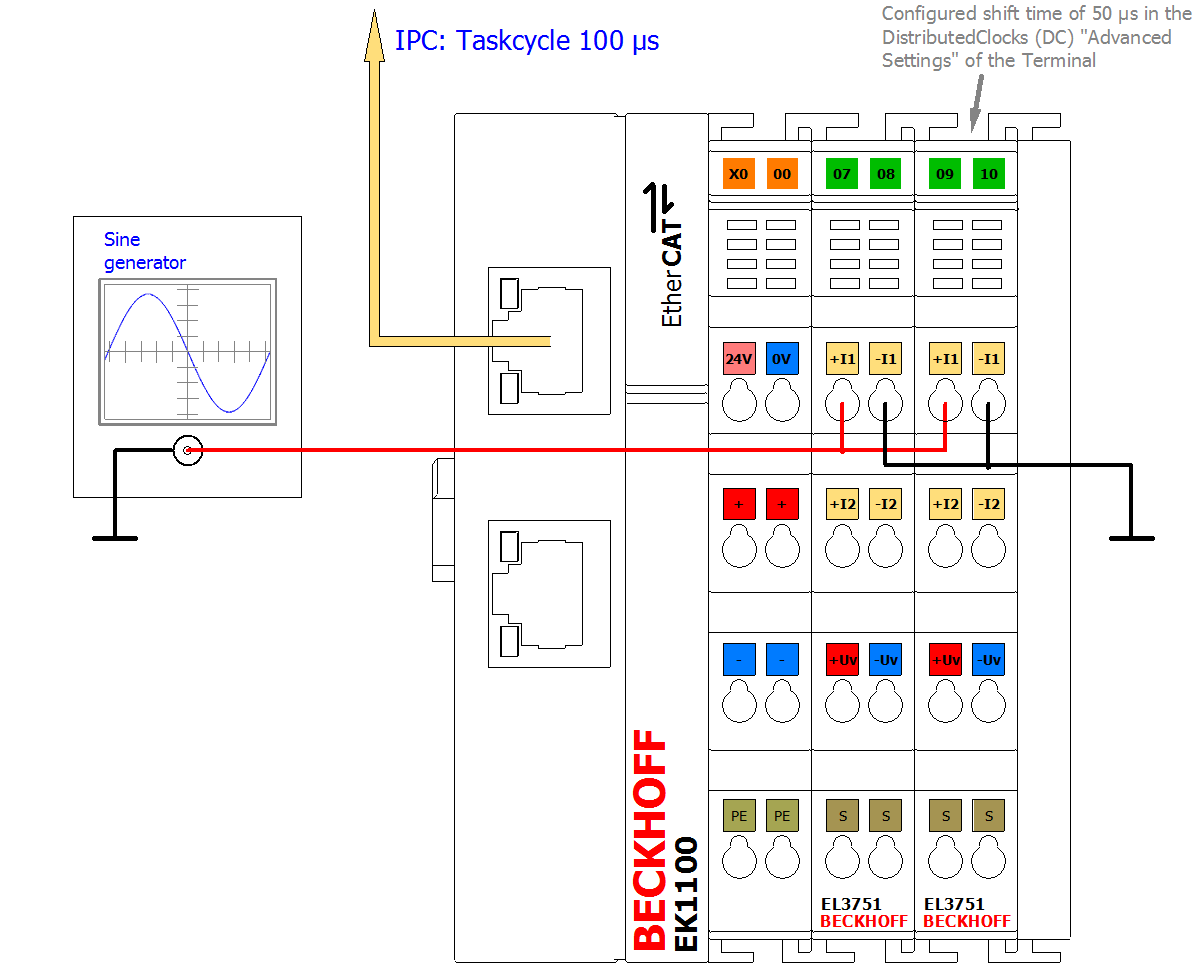

Fig.50: Process of interlacing the input dataThe following configuration is used for this purpose:
Fig.51: Configuration and setup for sample program 6: Doubling of the sample rate with 2 x EL3751The sample is also available with corresponding adaptations for other EL3xxx/ELM3xxx terminals or box modules. There may then be different oversampling factors, shift times, etc. The optionally existing task with 50 µs in sample 6a may then also not be usable.

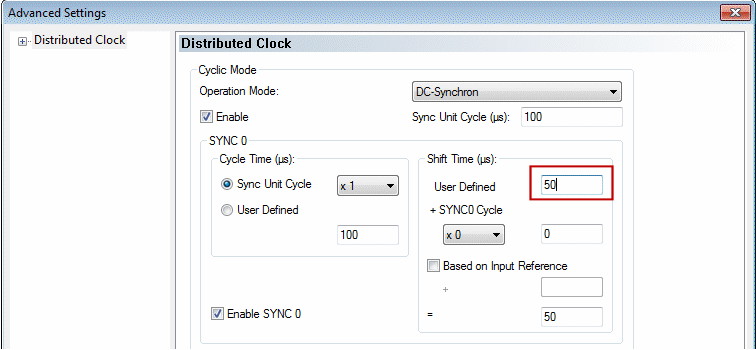

So that the input values can be successively combined to form a total value, a corresponding shift time is necessary for each channel/terminal; in this sample 50 µs for the second terminal. This is set in the "Advanced settings" for Distributed Clocks ("DC" tab) for the second terminal:
Fig.52: Setting the DC shift time for terminal 2Some notes and restrictions

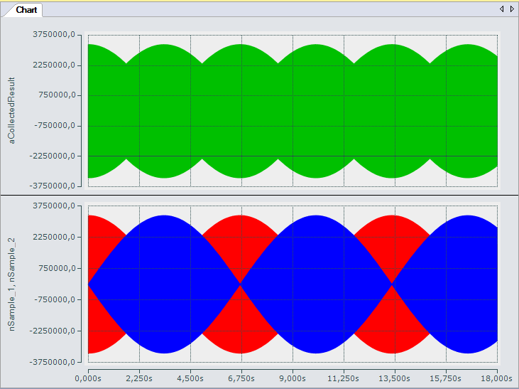

// Result pattern: 12121212... (--> see scope view dots)For an input signal with sine 5 kHz and 2.5 V amplitude, for example, the TwinCAT ScopeView provides the following results:
Fig.53: Oversampling 20 ksps with 2 x EL3751 with input signals (below) and result signal (top)The upper diagram shows the total signal and the two input signals (nSample_1, nSample_2), with a time shift of 50 µs relative to each other, within 18 s in compressed form. The total input signal (nCollectedResult) indicates the interlacing of the two input signals.

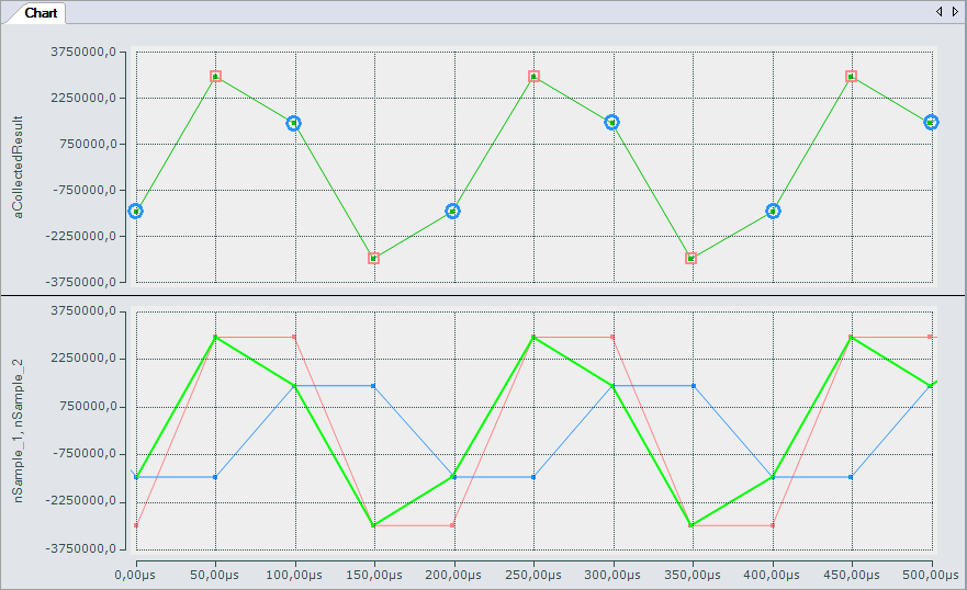

The following diagram (enhanced through highlighting) shows how the input signals (nSample_1, nSample_2) contribute to the structure of the total input signal:
Fig.54: Oversampling 20 ksps with 2 x EL3751 shows input value 1 and input value 2 alternately for a result valueUnder certain conditions, both inputs can be combined into a single variable in a correspondingly fast task. For this purpose the sample program contains an additional task with 50 µs cycle time, which is required for representing the input signals in the SopeView and contains a variable (nCollected) to which both inputs are assigned alternately:
