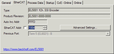

“EtherCAT” tab
![](Images/gif/1037226891__en-US__Web.gif)
Type | EtherCAT device type |
Product/Revision | Product and revision number of the EtherCAT device |
Auto Inc Addr. | Auto increment address of the EtherCAT device. The auto increment address can be used for addressing each EtherCAT device in the communication ring through its physical position. Auto increment addressing is used during the start-up phase when the EtherCAT master allocates addresses to the EtherCAT devices. With auto increment addressing the first EtherCAT slave in the ring has the address 0000hex. For each further slave the address is decremented by 1 (FFFFhex, FFFEhex etc.). |
EtherCAT Addr. | Fixed address of an EtherCAT slave. This address is allocated by the EtherCAT master during the start-up phase. Tick the control box to the left of the input field in order to modify the default value. |
Previous Port | Name and port of the EtherCAT device to which this device is connected. If it is possible to connect this device with another one without changing the order of the EtherCAT devices in the communication ring, then this combination field is activated and the EtherCAT device to which this device is to be connected can be selected. |
Advanced Settings | This button opens the dialogs for advanced settings. |
The link at the bottom of the tab points to the product page for this EtherCAT device on the web.
