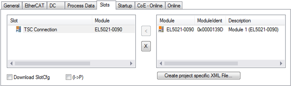

By default the TwinSAFE SC communication channel of the respective TwinSAFE SC component is not enabled. In order to be able to use the data transfer, the corresponding TwinSAFE SC module must first be added under the Slots tab. Only then is it possible to link to a corresponding alias device.
TwinSAFE SC - configuration 1:Fig.163: Adding the TwinSAFE SC process data under the component, e.g. EL5021-0090
Additional process data with the ID TSC Inputs, TSC Outputs are generated (TSC - TwinSAFE Single Channel).
TwinSAFE SC - configuration 2:Fig.164: TwinSAFE SC component process data, example EL5021-0090

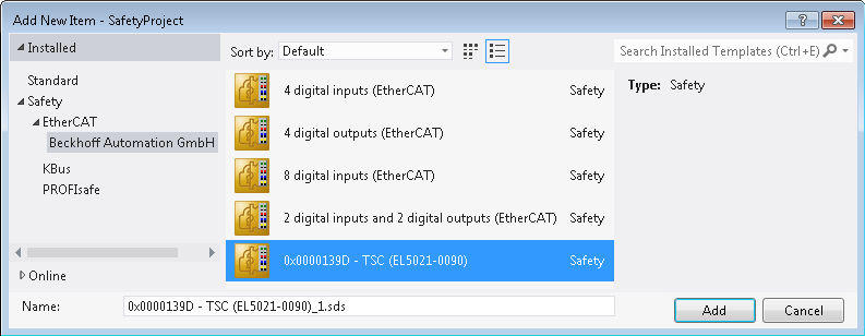

A TwinSAFE SC connection is added by adding an alias devices in the safety project and selecting TSC (TwinSAFE Single Channel)
TwinSAFE SC - configuration 3:Fig.165: Adding a TwinSAFE SC connection

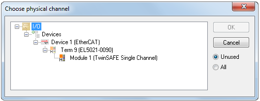

After opening the alias device by double-clicking, select the Link button TwinSAFE SC - configuration 4: next to Physical Device, in order to create the link to a TwinSAFE SC terminal. Only suitable TwinSAFE SC terminals are offered in the selection dialog.
TwinSAFE SC - configuration 5:Fig.166: Creating a link to TwinSAFE SC terminal

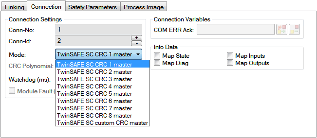

The CRC to be used can be selected or a free CRC can be entered under the Connection tab of the alias device.
Entry Mode
Used CRCs
TwinSAFE SC CRC 1 master
0x17B0F
TwinSAFE SC CRC 2 master
0x1571F
TwinSAFE SC CRC 3 master
0x11F95
TwinSAFE SC CRC 4 master
0x153F1
TwinSAFE SC CRC 5 master
0x1F1D5
TwinSAFE SC CRC 6 master
0x1663B
TwinSAFE SC CRC 7 master
0x1B8CD
TwinSAFE SC CRC 8 master
0x1E1BD

These settings must match the settings in the CoE objects of the TwinSAFE SC component.

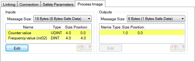

The TwinSAFE SC component initially makes all available process data available. The Safety Parameters tab typically contains no parameters. The process data size and the process data themselves can be selected under the Process Image tab.
TwinSAFE SC - configuration 7:Fig.168: Selecting the process data size and the process data

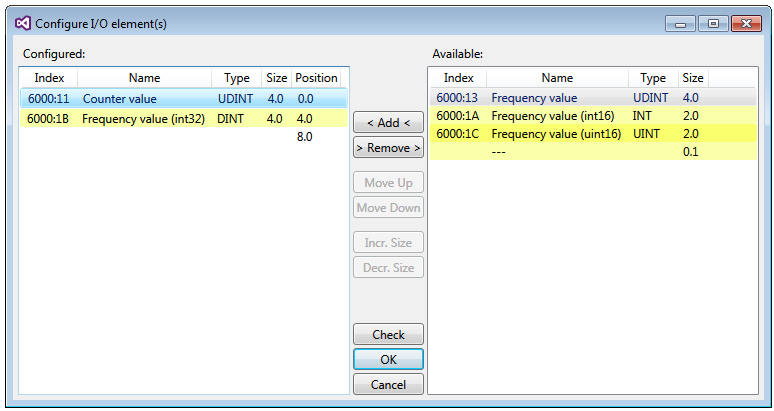

The process data (defined in the ESI file) can be adjusted to user requirements by selecting the Edit button in the dialog Configure I/O element(s).
TwinSAFE SC - configuration 8:Fig.169: Selection of the process data

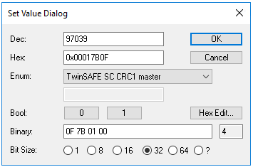

The safety address together with the CRC must be entered on the TwinSAFE SC slave side. This is done via the CoE objects under TSC settings of the corresponding TwinSAFE SC component (here, for example, EL5021-0090, 0x8010: 01 and 0x8010: 02). The address set here must also be set in the alias device as FSoE address under the Linking tab.
Under the object 0x80n0:02 Connection Mode the CRC to be used is selected or a free CRC is entered. A total of 8 CRCs are available. A free CRC must start with 0x00ff in the high word.
TwinSAFE SC - configuration 9:Fig.170: CoE objects 0x8010:01 and 0x8010:02
