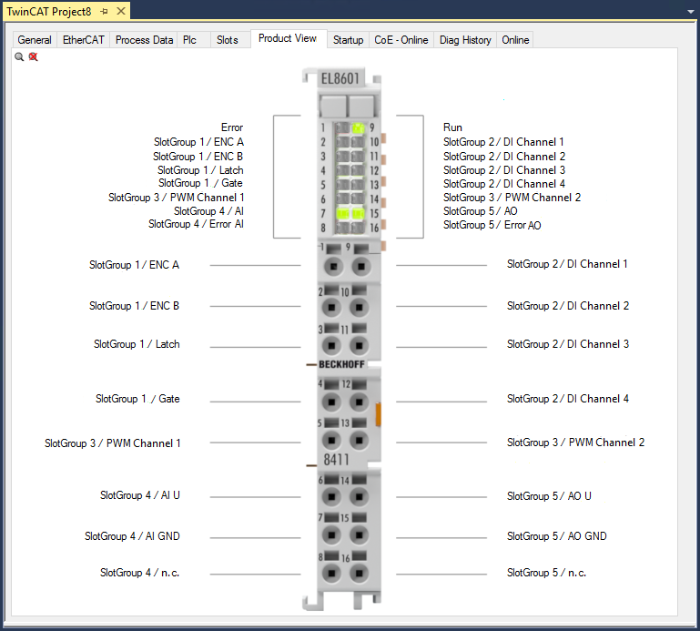

Connections in the "Product View" tab
The "Product View" tab shows the connections of the product according to the current configuration. This makes it easier to assign the individual signal types to the connection points, especially for multi-interface products. To make it easier to assign the connections, the designation also contains the corresponding SlotGroup in addition to the function.
For some products, the LED status is also displayed in real-time in the "Product View" tab. The LED status display is currently only supported for products that have the "LED status" CoE object.
Requirement for displaying the "Product View" tab:
- Development environment TwinCAT 3.1 Build 4024.59
After making changes in the "Slots" area, refresh the view as follows:
- The project must be saved for offline configuration.
- With an online configuration, a "Reload Devices"
is sufficient to refresh the view.
Fig.3: View in the "Product View" tab using the EL8601-8411 as an exampleA detailed description of the connections can be found in the chapter "Connections". |
