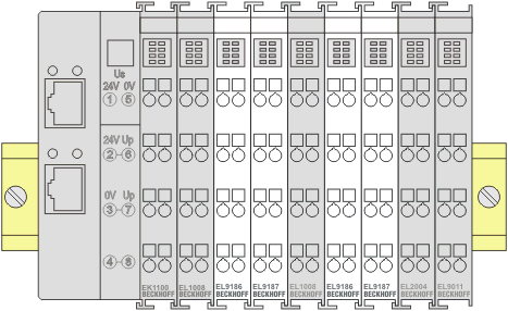

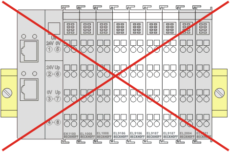

Positioning of passive Terminals
![]() | Hint for positioning of passive terminals in the bus terminal block EtherCAT Terminals, which do not take an active part in data transfer within the bus terminal block are so called passive terminals. The passive terminals have no current consumption out of the E-Bus. |
Examples for positioning of passive terminals (highlighted)
Fig.12: Correct positioning
Fig.13: Incorrect positioning
