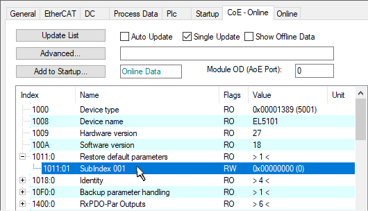

To restore the delivery state (factory settings) of CoE objects for EtherCAT devices (“slaves”), the CoE object Restore default parameters, SubIndex 001 can be used via EtherCAT master (e.g. TwinCAT) (see Fig. Selecting the Restore default parameters PDO).
 Fig.167: Selecting the Restore default parameters PDO

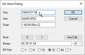

Fig.167: Selecting the Restore default parameters PDO Fig.168: Entering a restore value in the Set Value dialog
Fig.168: Entering a restore value in the Set Value dialogDouble-click on SubIndex 001 to enter the Set Value dialog. Enter the reset value 1684107116 in field Dec or the value 0x64616F6C in field Hex (ASCII: “load”) and confirm with OK (Fig. Entering a restore value in the Set Value dialog).
