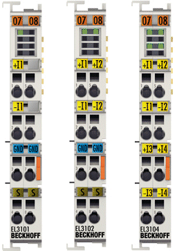

EL310x
1, 2 and 4 channel analog input terminals -10…+10 V, differential inputs, 16 bit
The EL310x analog input terminals measure input voltages from -10 to +10 V.
The significantly faster conversion time and support for distributed clocks enable use in time-critical applications and set them apart from the EL30xx series.
The differential inputs of the EL3101/EL3102 have the same reference ground, which is not connected to the power contacts.
In the EL3104, the common reference ground is connected to the 0 V power contact.
