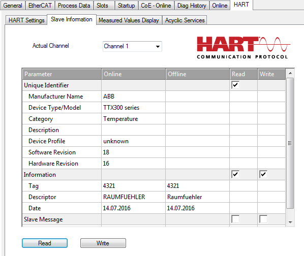

Slave Information
The "Slave Information" dialog can be used to read and write general information from and to the connected slave.
The checkboxes can be used to select the data to be read and written.
The following rules apply for the data to be written:
- Tag 8 Bytes Packed ASCII
- Descriptor 16 Bytes Packed ASCII
- Date Format xx.yy.zzzz
- Message 32 Bytes Packed ASCII
![]() | Lower-case letters for packed ASCII Lower-case letters are not allowed for packed ASCII. If lower-case letters are used, they are automatically converted to capital letters. |
