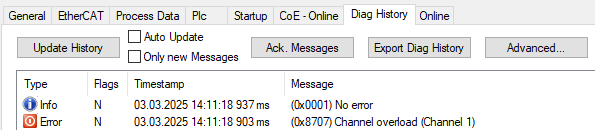

Diag-Messages 1:
Fig.22: Display in TwinCAT 3.1, example
