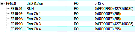

The status of the terminal LEDs can be read electronically as follows:
Index
LED name
0xF915:01
RUN
0xF915:02
OK/Error
Device diagnostic functions 1:
Fig.19: Subindices Index F915, exemplary values
Flashing/lighting code in the 1st byte:
Device diagnostic functions 2:
Fig.20: Legend
Examples:
Device diagnostic functions 3:
Fig.21: Examples LED status
