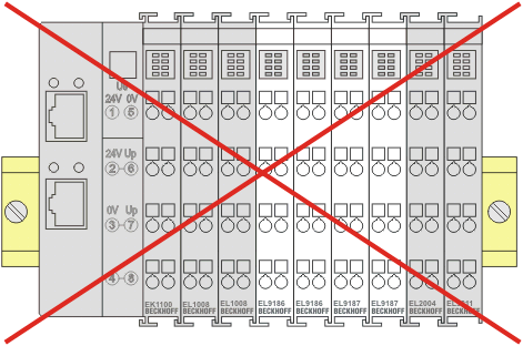

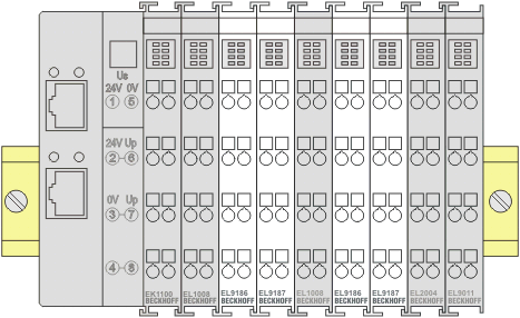

Positioning of passive Terminals
|  | Hint for positioning of passive terminals in the bus terminal block EtherCAT Terminals (ELxxxx / ESxxxx), which do not take an active part in data transfer within the bus terminal block are so called passive terminals. The passive terminals have no current consumption out of the E-Bus.  |
Examples for positioning of passive terminals (highlighted)
 Fig.22: Correct positioning
Fig.22: Correct positioning Fig.23: Incorrect positioning
