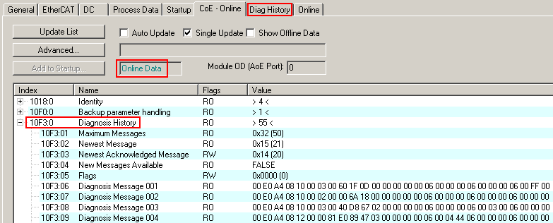

In the CoE both the control entries and the history itself can be found in the CoE object 0x10F3:
Fig.142: DiagMessages in the CoEThe subindex of the latest DiagMessage can be read under 0x10F3:02.

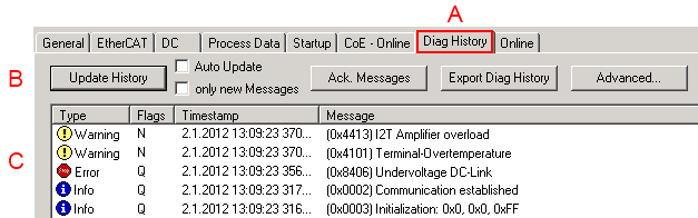

From TwinCAT 2.11 DiagMessages, if available, are displayed in the device’s own interface. Operation (collection, confirmation) also takes place via this interface.
Fig.143: Implementation of the DiagMessage system in the TwinCAT System ManagerThe operating buttons (B) and the history read out (C) can be seen on the Diag History tab (A). The components of the message:
- Info/Warning/Error
- Acknowledge flag (N = unconfirmed, Q = confirmed)
- Time stamp
- Text ID
- Plain text message according to ESI/XML data
The meanings of the buttons are self-explanatory.

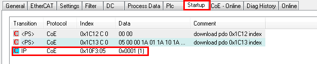

In the latest developments, the EtherCAT Terminals are set by default to report the presence of a DiagMessage as emergency via EtherCAT; the event logger can then retrieve the DiagMessage. The function is activated in the terminal via 0x10F3:05, so such terminals have the following entry in the StartUp list by default:
Fig.144: Startup ListIf the function is to be deactivated because, for example, many messages come in or the EventLogger is not used, the StartUp entry can be deleted or set to 0. The value can then be set back to 1 later from the PLC via CoE access if required.
