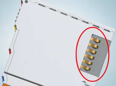

The devices contain components at risk from electrostatic discharge caused by improper handling.
  • When handling the components, ensure that there is no electrostatic discharge; also avoid touching the spring contacts directly (see illustration).

Instructions for ESD protection 1:Fig.16: Spring contacts of the Beckhoff I/O components
