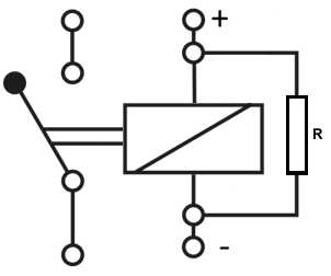

1. Resistance parallel to inductance
Output protection during DC switching of inductive loads (overvoltage limitation) 1:Fig.12: Resistance parallel to inductance
It is a very simple method, but one in which current constantly flows uselessly past the coil. This circuit is also known as snubbers.
Note: An RC element is common for AC excitation. However, it must be designed very precisely to ensure optimum operation (time behavior, power loss).

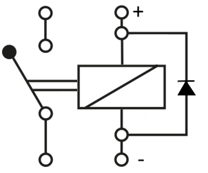

Output protection during DC switching of inductive loads (overvoltage limitation) 2:Fig.13: Short-circuit diode on the inductance, free-wheeling diode
This solution is often the most appropriate for DC excitation and should be considered first. It reliably protects the output as the self-induction voltage is limited to approx. -1 V (even less if a Schottky diode is used). In addition, it is usually easy to dimension, as hardly any power is dissipated via the diode with small DC inductances.
However, the induction voltage only drops very slowly (a few ms), which can be disadvantageous for relays as a switching load or if fast shutdown is desired.
Note: In the event of expected power failures, however, this latching effect may be desirable to prevent the relay from dropping too early.

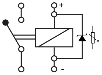

Output protection during DC switching of inductive loads (overvoltage limitation) 3:Fig.14: Example circuit with Zener diode

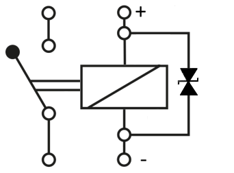

Output protection during DC switching of inductive loads (overvoltage limitation) 4:Fig.15: Example circuit with bidirectional suppressor diode (Transient Voltage Suppressor)
This solution ensures that the load drops relatively quickly (a relay may be required). The coil is not short-circuited, but must dissipate its energy at a higher voltage. This means that the magnetic field can collapse quickly. It should be noted that the semiconductor can become very warm.
The reverse voltage of the Zener diode must be significantly higher than the regular operating voltage, otherwise normal operation is not possible. In a 24 V industrial system (usually up to approx. 29 V are permissible), for example, it is 35 V. Such diodes are also often used in 24 V DC power supplies to temporarily short-circuit transients!
