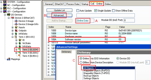

Determining the version via the TwinCAT System Manager
The TwinCAT System Manager shows the version of the controller firmware if the master can access the slave online. Click on the E-Bus Terminal whose controller firmware you want to check (in the example terminal 2 (EL3204)) and select the tab CoE Online (CAN over EtherCAT).
|  | CoE Online and Offline CoE Two CoE directories are available:  The Advanced button must be used for switching between the two views. |
In Fig. Display of EL3204 firmware version the firmware version of the selected EL3204 is shown as 03 in CoE entry 0x100A.
 Fig.173: Display of EL3204 firmware version
Fig.173: Display of EL3204 firmware versionIn (A) TwinCAT 2.11 shows that the Online CoE directory is currently displayed. If this is not the case, the Online directory can be loaded via the Online option in Advanced Settings (B) and double-clicking on AllObjects.
