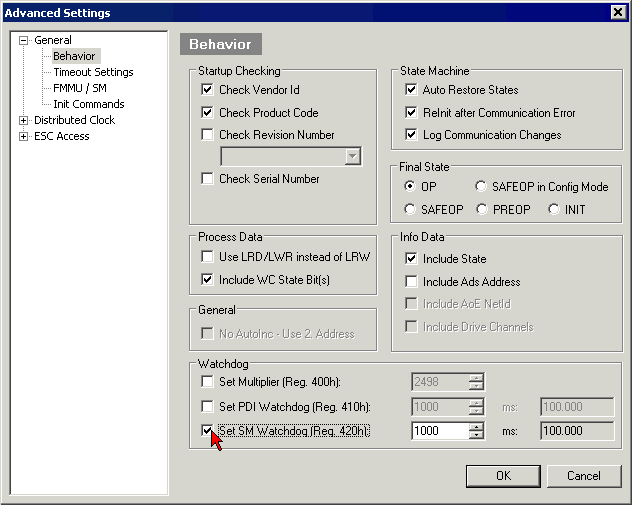

Their times are individually parameterized in TwinCAT as follows:
Notes:
- the Multiplier Register 400h (hexadecimal, i.e. x0400) is valid for both watchdogs.
- each watchdog has its own timer setting 410h or 420h, which together with the Multiplier results in a resulting time.
- important: the Multiplier/Timer setting is only loaded into the slave at EtherCAT startup if the checkbox in front of it is activated.
- if it is not checked, nothing is downloaded and the setting located in the ESC remains unchanged.
- the downloaded values can be seen in the ESC registers x0400/0410/0420: ESC Access -> Memory

Calculation
Watchdog time = [1/25 MHz * (Watchdog multiplier + 2) ] * PDI/SM watchdog
Example: default setting Multiplier=2498, SM watchdog=1000 -> 100 ms
The value in Multiplier + 2 corresponds to the number of 40ns base ticks representing one watchdog tick.
