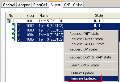

Simultaneous updating of several EtherCAT devices
The firmware and ESI descriptions of several devices can be updated simultaneously, provided the devices have the same firmware file/ESI.
Fig.141: Multiple selection and firmware update Select the required slaves and carry out the firmware update in BOOTSTRAP mode as described above.
