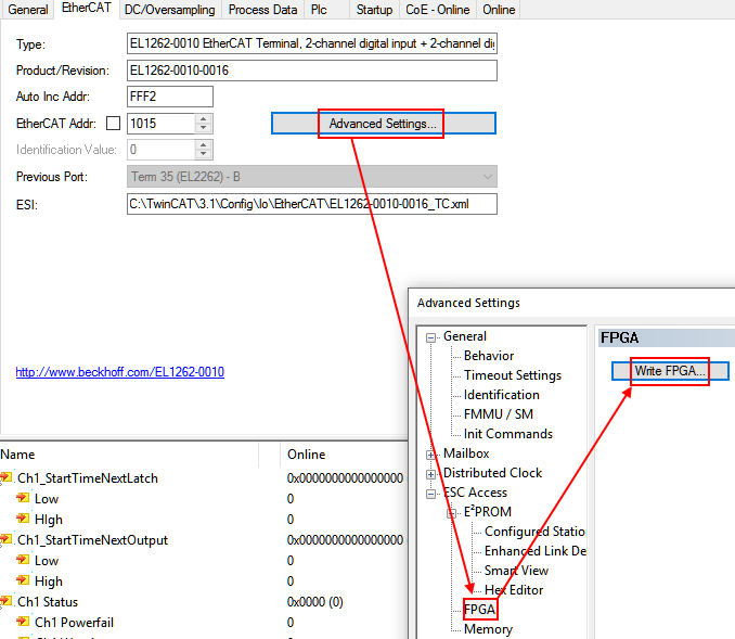

FPGA update

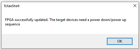

As FPGA zip file:
 *select .zip file, takes several minutes, note progress bar
*select .zip file, takes several minutes, note progress bar  , runs through twice
Ok:

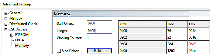

The FPGA state can be viewed in register x0E00

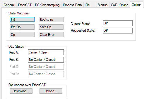

The µC firmware update has to be done as usual, e.g. via the dialog
Procedure: Set device to bootstrap, load *.efw file into device.

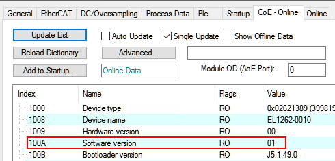

The current FW status can be viewed in the CoE directory
