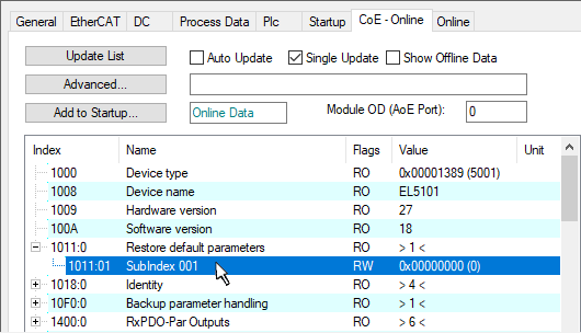

Some EtherCAT devices (“Slaves”, “SubDevices”) save parameters or data locally in a persistent (non-volatile) manner. To reset them, the CoE object Restore default parameters, subindex 001 can be used via an EtherCAT master (e.g. TwinCAT) (see Fig. Selecting the “Restore default parameters” PDO)
Fig.237: Selecting the Restore default parameters PDO

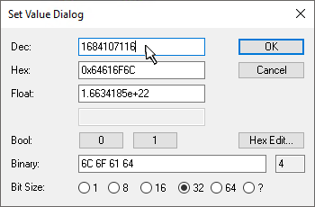

Fig.238: Entering a restore value in the Set Value dialogDouble-click on SubIndex 001 to open the Set Value dialog.

Enter the reset value 1684107116 in the Dec field or alternatively the value 0x64616F6C in the Hex field (ASCII: “load”) and confirm with OK (Fig. Entering the restore value in the Set Value dialog).

Enter the reset value 2003398757 in the Dec field or alternatively the value 0x77697065 in the Hex field (ASCII: “wipe”) and confirm with OK (Fig. Entering the restore value in the Set Value dialog).
