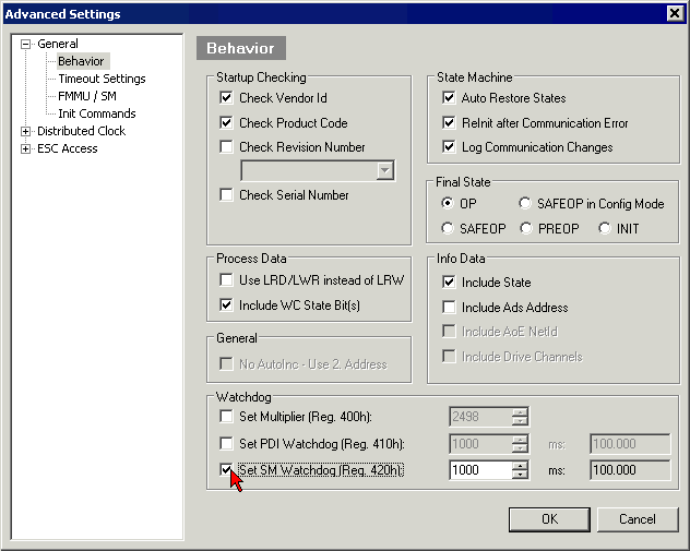

Their times are individually parameterized in TwinCAT as follows:
General notes for setting the watchdog 1:Fig.16: eEtherCAT tab -> Advanced Settings -> Behavior -> Watchdog

SM watchdog (SyncManager Watchdog)
The SyncManager watchdog is reset with each successful EtherCAT process data communication with the terminal. If, for example, no EtherCAT process data communication with the terminal takes place for longer than the set and activated SM watchdog time due to a line interruption, the watchdog is triggered. The status of the terminal (usually OP) remains unaffected. The watchdog is only reset again by a successful EtherCAT process data access.
The SyncManager watchdog is therefore a monitoring for correct and timely process data communication with the ESC from the EtherCAT side.
The maximum possible watchdog time depends on the device. For example, for "simple" EtherCAT slaves (without firmware) with watchdog execution in the ESC it is usually up to 170 seconds. For complex EtherCAT slaves (with firmware) the SM watchdog function is usually parameterized via register 400h/420h but executed by the microcontroller (µC) and can be significantly lower. In addition, the execution may then be subject to a certain time uncertainty. Since the TwinCAT dialog may allow inputs up to 65535, a test of the desired watchdog time is recommended.
PDI watchdog (Process Data Watchdog)
If there is no PDI communication with the ESC for longer than the set and activated Process Data Interface (PDI) watchdog time, this watchdog is triggered.
The PDI is the internal interface of the ESC, e.g. to local processors in the EtherCAT slave. With the PDI watchdog this communication can be monitored for failure.
The PDI watchdog is therefore a monitoring for correct and timely process data communication with the ESC, but viewed from the application side.
Calculation
Watchdog time = [1/25 MHz * (Watchdog multiplier + 2)] * SM/PDI watchdog
Example: default setting Multiplier = 2498, SM watchdog = 1000 => 100 ms
The value in “Watchdog multiplier + 2” in the formula above corresponds to the number of 40ns base ticks representing one watchdog tick.
