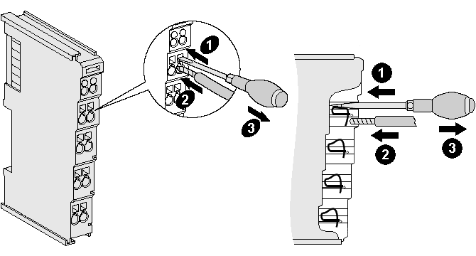

Wiring 1:Fig.48: Connecting a cable on a terminal point
Up to eight terminal points enable the connection of solid or finely stranded cables to the bus terminal. The terminal points are implemented in spring force technology. Connect the cables as follows (see fig. “Connecting a cable on a terminal point”:
  1. Open a terminal point by pushing a screwdriver straight against the stop into the square opening above the terminal point. Do not turn the screwdriver or move it alternately (don't toggle).
  2. The wire can now be inserted into the round terminal opening without any force.
  3. When the screwdriver is removed, the terminal point closes automatically and holds the wire securely and permanently in place
