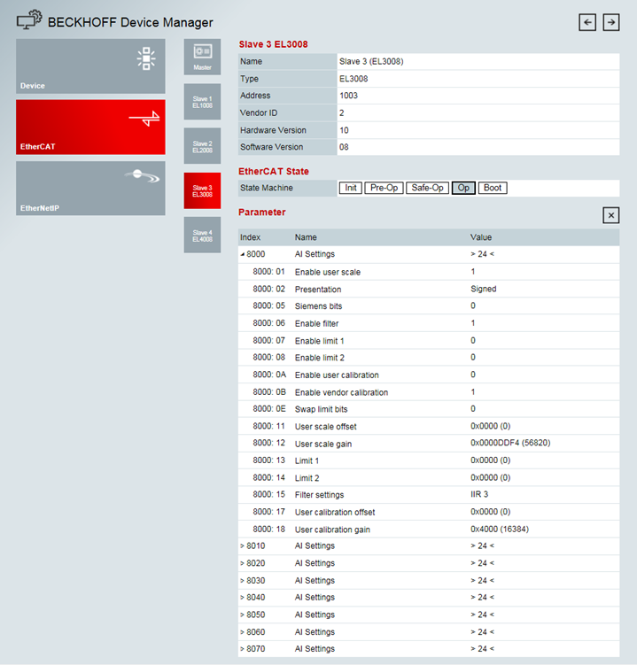

EtherCAT configuration
EtherCAT Terminals can be configured and parameterized via the HTML page Beckhoff Device Manager.
EtherCAT configuration 1:Fig.19: Configuration via HTML pages - EtherCAT configuration
EtherCAT configuration 2:Fig.20: Configuration via HTML pages - parameterizing EtherCAT Terminals

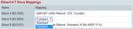

EtherCAT Slaves Mappings
In some EtherCAT Terminals, the process image can be changed; it must be stored in the EtherCAT master.
The terminals that can be changed are displayed under "EtherCAT Slaves Mapping"; the corresponding mapping must be set and stored in the Restore file. The coupler is then restarted so that it can activate the mapping (attention: the process image is changed as a result).
EtherCAT configuration 3:Fig.21: Configuration via HTML pages - EtherCAT slave mappings
Parameterization of the EtherCAT Terminals
To parameterize an EtherCAT Terminal, select the required terminal. Its objects are then displayed and can be edited if necessary. The settings are then stored in the terminal. Note that any modifications are lost if the terminal is replaced. In this case, use the restore file, which contains your modifications.
Restore file overwrites EtherNet/IP modifications
If the Restore File is used, the object parameters are always loaded into the terminal on starting the coupler. This will overwrite changes that you have made via the web page.
