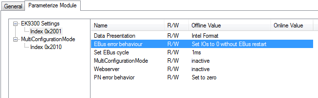

EBus Error Behaviour
EBus Error Behaviour 1:Fig.51: The parameter EBus error behavior
This parameter is used to set the response to an E-bus error. The following options are available:
Legacy
Output data is still written, input data is frozen and therefore no longer current.
Set IOs to 0
Output data is written to zero; input data is written to zero; when the E-bus is error-free, it automatically starts the data exchange.
Set IOs to 0 without EBus restart
(Default setting)
Output data is written to zero; input data is written to zero; when the E-bus is error-free, it can be activated again via the record data (see below).
