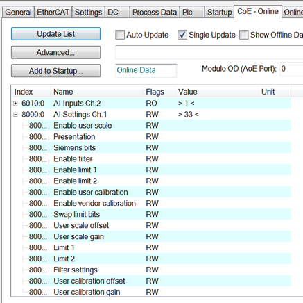

• Parameter data (CoE)
The parameter data of an EC slave is transmitted via CoE (CAN over EtherCAT). As with CAN, it is divided into objects, subobjects and data. Parameter data is, for example, data that sets the resistance value for an EL3202 terminal, i.e., a temperature resistance terminal, such as PT100, PT1000, NI100, and so on.
Only the application-specific CoE data is made available at the EK coupler. Depending on the higher-level bus system, all or only some CoE objects can be accessed here.
Here, too, parameterization can take place via a web page (http protocol) in the EK.

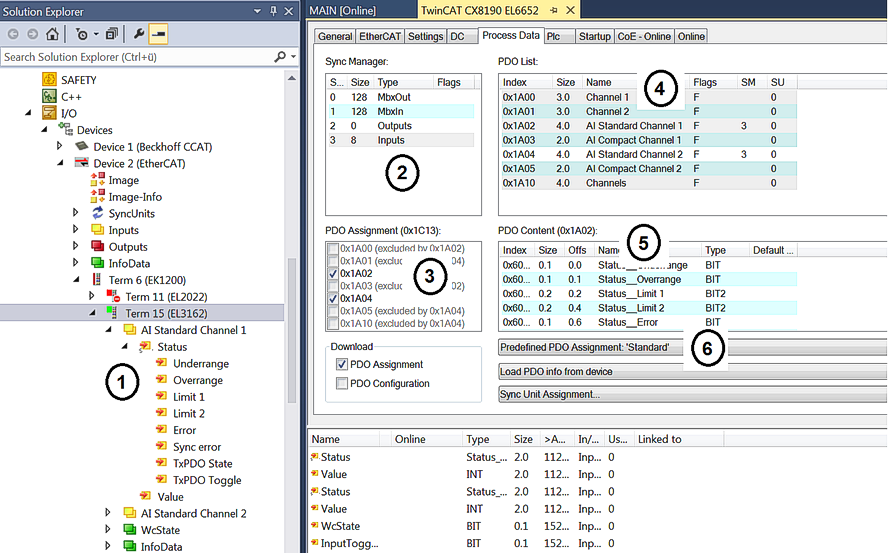

• How do I get a description of the EtherCAT process data?
The predefined PDOs usually consist of different PDOs and are a compilation of different PDOs of the process image.
In the following, this is illustrated with the TwinCAT automation software:
Representation of an EtherCAT slave on PROFINET 1:Fig.16: Typical configuration page of an EtherCAT Terminal
Key:
  1. The EtherCAT Terminal is inserted in the TwinCAT tree and has process data that can be linked to the PLC program.
  2. View of the existing process data in bytes (exactly this number and size can be seen with PROFINET and the Siemens control, Siemens does not show the process data in more detail although it is described in the GSDML)
  3. Display which PDOs are active in the process data
  4. View of all PDOs
  5. Detail of individual PDOs that can be selected in "4"
  6. Predefined PDOs
In the GSDML only the predefined PDOs are selectable (6). If a different combination of PDOs is desired, this can only be done via a Beckhoff controller, such as the CX8093, which has a default PROFINET interface and is programmable with TwinCAT 2 (with TwinCAT 3 a CX9020 with B930 interface is required, or any Beckhoff controller with an EL6631-0010).

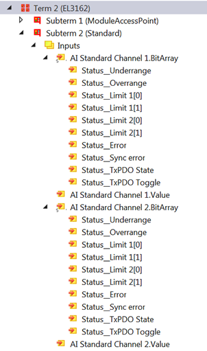

Representation of an EtherCAT slave on PROFINET 2:Fig.17: Example mapping of an EL3162 m standard format (8 byte IN / 0 byte OUT)

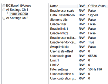

Parameter data
In the following, the parameter or configuration data will be explained. Most of the necessary configuration data is contained in the GSDML; Beckhoff uses the same names and meanings here as on the EtherCAT side, which is contained in the ESI file2) in the CoE description.
Representation of an EtherCAT slave on PROFINET 3:Fig.18: EtherCAT: Parameter data of the EL3162 of the ESI under TwinCAT
Representation of an EtherCAT slave on PROFINET 4:Fig.19: PROFINET: Parameter data of the EL3162 of the GSDML under TwinCAT
2) The ESI file is the description file for EtherCAT masters (ESI EtherCAT slave information).
These parameters for the individual terminals can also be found in the configuration tool of your PROFINET controller, regardless of which manufacturer you use here. You can also access individual parameters acyclically via PROFINET and the record data. To do this, the PROFIENT controller must have an interface to the record data. A CoE protocol description and how it can be used via PROFINET is described in the EK9300 manual.
