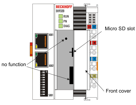

Further interfaces
Additional interfaces are located under the flap of the EK9xx0.
Further interfaces 1:Fig.15: Interface of the EK9320
Micro SD card
The firmware of the EK9320 is loaded exclusively from the micro SD card in the micro SD slot.
Battery
No battery is required for the EK9xx0, therefore this option is not included.
