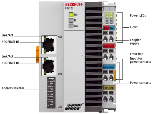

Diagnostic LEDs
Diagnostic LEDs 1:Fig.5: EK9320 LEDs
Ethernet interface X001
Interface X001/X002
Ethernet
Meaning
LED green
on
Link available/activity
LED yellow
is not used
LEDs coupler
Labelling
Meaning
Color
Meaning
RUN
Indicates the status of the coupler
red
May only light up during the start-up phase
Green
Coupler is ready
Blue
(If red DIP switch 1 is set to on when starting the coupler)
The internal Flash can be reached via USB (firmware update)
LED PN
PROFINET status
Meaning
green
red
Power On
off
200 ms flashing
Start-up phase
No name
200 ms flashing
off
no Profinet name
No IP
1 s off, 200 ms on
off
No IP address
Run
on
off
OK
LED DIAG
PROFINET diagnosis
Meaning
green
red
Flashing, PN controller identification
500 ms
500 ms
The PN controller is transmitting an identification signal
No AR established
off
200 ms flashing
The establishment of a connection with the controller has not been completed
Device is in IO exchange
Error display of Outputs CR is set to module differences
1 s off, 200 ms on
off
Problem with establishment of a connection or nominal and actual configuration differ
Device is in IO exchange but provider is in stop
200 ms
off
Coupler is in data exchange, but PLC is in stop
on
off
OK
LED power supply terminal
Diagnostic LEDs 2:Fig.51: LED power supply terminal
Operation with E-bus terminals
Display LED
Meaning
1 Us 24 V (top left, 1st row)
CX8000 supply voltage
on: connected to: 24 V
2 Up 24 V (top right, 1st row)
Power contacts supply voltage
3 L/A (left center,  2nd row)
EtherCAT LED
flashing green: EtherCAT communication active
on: E-bus connected / no data traffic
off: E-bus not connected
