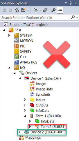

- Was the correct terminal used?
- EL663x-0000 cannot be used as device
- EL6631-0010 cannot be used as controller
EL663x-00x0 EtherCAT Terminals
Fig.56: Wrong configuration

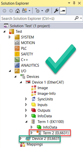

Fig.57: Correct configuration- EtherCAT diagnostics
- EtherCAT state = Operational (OP)
- WcState = 0 (Data valid)
