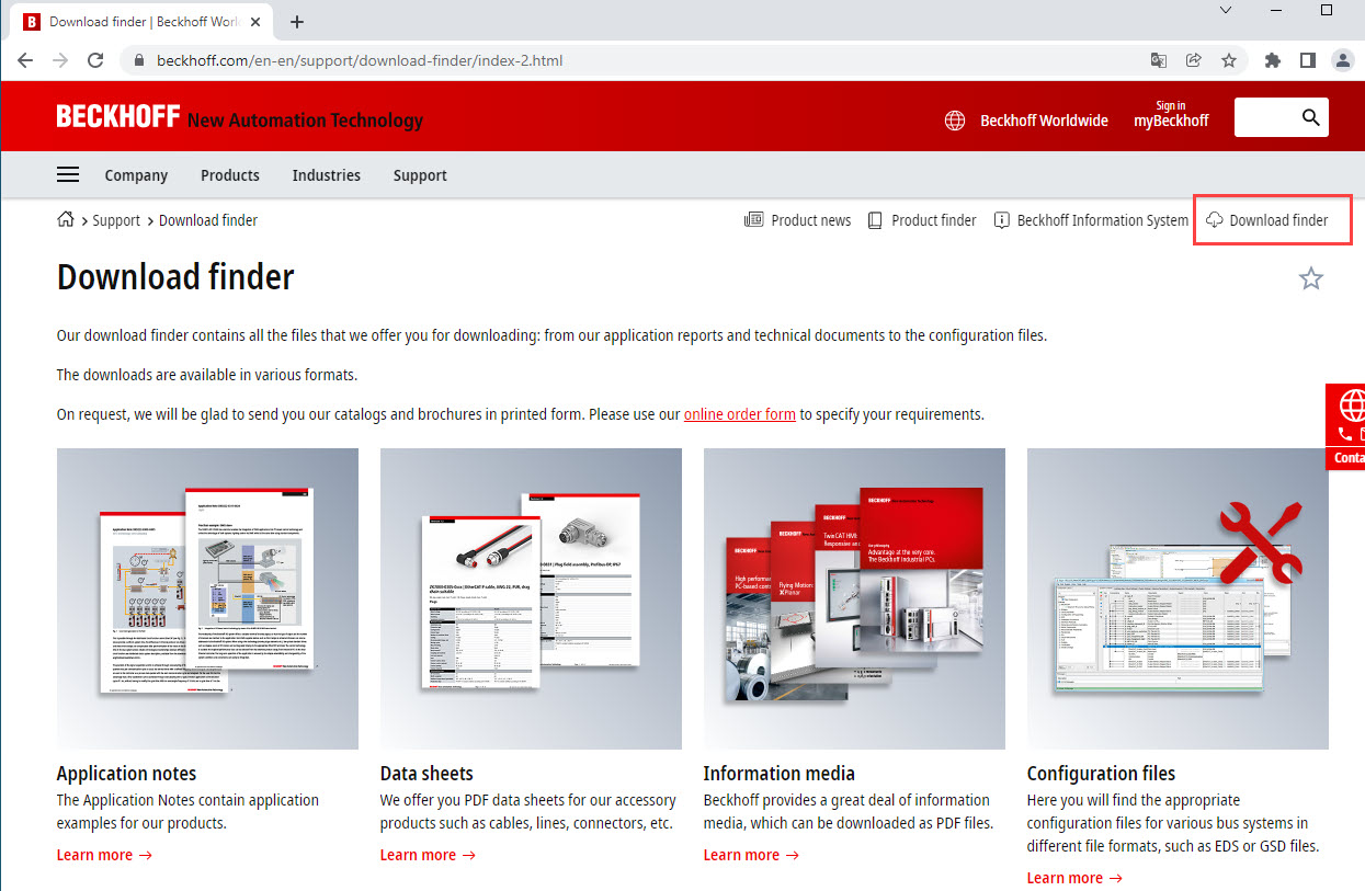

- Where can I find GSDML files?
- From Beckhoff products the GSDML files are usually delivered with the installation of TwinCAT.

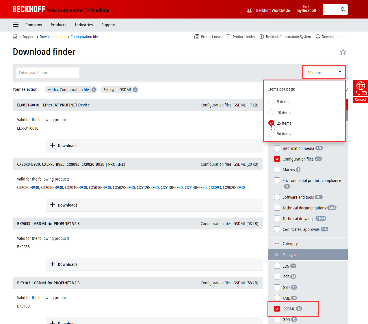

- On the Beckhoff website, use the "Download Finder" and its filter options for this purpose
Fig.54: Website Download finder
Fig.55: Website Download finder (filtered)- For products from other suppliers/manufacturers, the supplier must be contacted or the GSDML files can be downloaded from the website.
