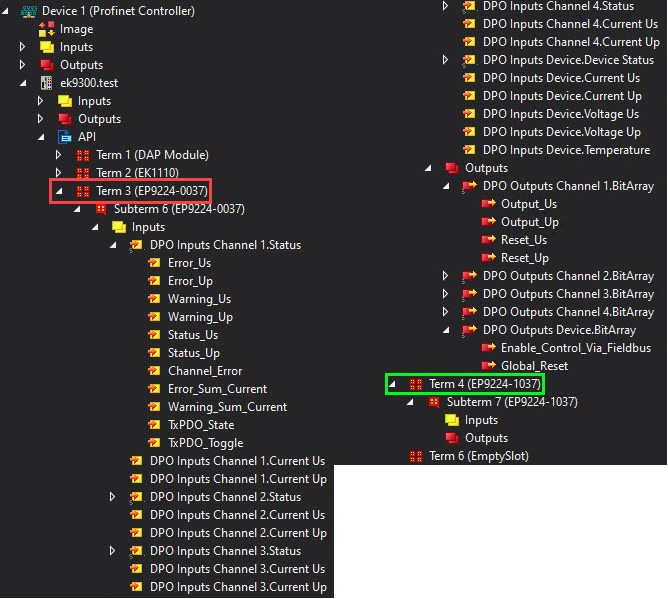

This chapter describes the commissioning or the implementation of the EP9224-0037 into TwinCAT and TIA. Because the EP9224-0037 contains two EtherCAT slave controllers (ESC), two EP9224 must also be implemented during configuration. In the automation software these are represented once with the ending -0037 and once with -1037. For more information on the process image, refer to the documentation of EP9224-0037.
Fig.36: Representation EP9224-0037 in TwinCAT
Fig.37: Representation EP9224-0037 in TIAEach IO module has four ports. Some of these ports are used internally as interfaces to each other, which are not accessible to the user. The others are available as interfaces to the connectors on the EP box. The following illustration shows the assignment of the connectors to the ports of the I/O modules.

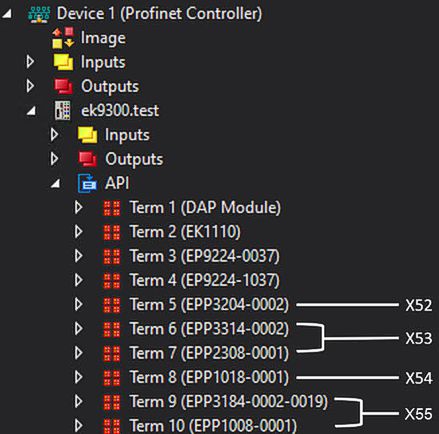

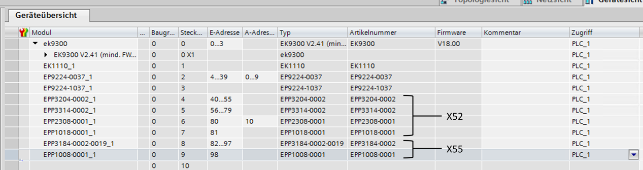

Sample configuration 1
Type | EP9224-0037 | Automation software | EtherCAT devices | |||
Connector | IO module | Port | 1. | 2. | n. | |
EtherCAT P output | X52 | EP9224-1037 | D | EPP3204 | - | - |
EtherCAT P output | X53 | B | EPP3314 | EPP2308 | - | |
EtherCAT P output | X54 | C | EPP1018 | - | - | |
EtherCAT P output | X55 | EP9224-0037 | B | EPP3184 | EPP1008 | - |
EtherCAT input | X70 | A |
EtherCAT output | X71 | C |
Fig.39: Sample configuration 1 TwinCAT

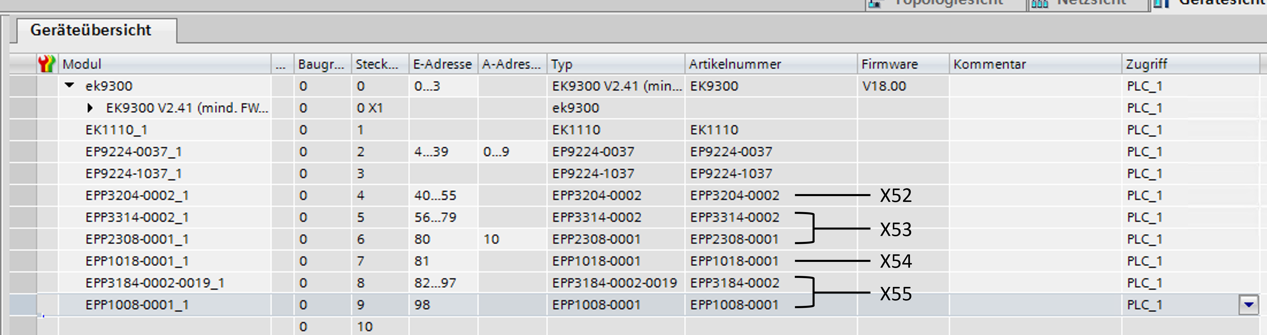

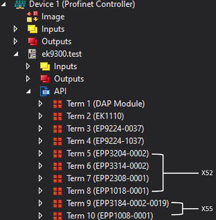

Fig.40: Sample configuration 1 TIASample configuration 2
Type | EP9224-0037 | Automation software | EtherCAT devices | |||||
Connector | IO module | Port | 1. | 2. | 3. | 4. | n. | |
EtherCAT P output | X52 | EP9224-1037 | D | EPP3204 | EPP3314 | EPP2308 | EPP1018 | - |
EtherCAT P output | X53 | B | - | - | - | - | - | |
EtherCAT P output | X54 | C | - | - | - | - | - | |
Fig.41: Sample configuration 2 TwinCAT
Fig.42: Sample configuration 2 TIA
