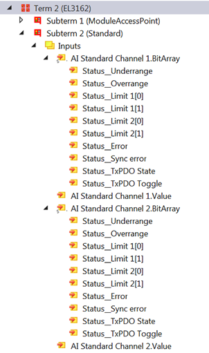

Representation of an EtherCAT slave on PROFINET 2:Fig.17: Example mapping of an EL3162 m standard format (8 byte IN / 0 byte OUT)
Size (variable)
Bit offset
AI Standard Channel 1.BitArray
Status_Underrange
BIT (BOOL)
0.0
Status_Overrange
BIT (BOOL)
0.1
Status_Limit_1[0]
BIT (BOOL)
0.2
Status_Limit_1[0]
BIT (BOOL)
0.3
Status_Limit_1[0]
BIT (BOOL)
0.4
Status_Limit_1[0]
BIT (BOOL)
0.5
Status_Error
BIT (BOOL)
0.6
Status_Sync error
BIT (BOOL)
1.5
Status_TxPDO State
BIT (BOOL)
1.6
Status_TxPDO Toggle
BIT (BOOL)
1.7
AI Standard Channel 1.Value
16 BIT (INT)
2.0..3.7
AI Standard Channel 2.BitArray
Status_Underrange
BIT (BOOL)
4.0
Status_Overrange
BIT (BOOL)
4.1
Status_Limit_1[0]
BIT (BOOL)
4.2
Status_Limit_1[0]
BIT (BOOL)
4.3
Status_Limit_1[0]
BIT (BOOL)
4.4
Status_Limit_1[0]
BIT (BOOL)
4.5
Status_Error
BIT (BOOL)
4.6
Status_Sync error
BIT (BOOL)
5.5
Status_TxPDO State
BIT (BOOL)
5.6
Status_TxPDO Toggle
BIT (BOOL)
5.7
AI Standard Channel 2.Value
16 BIT (INT)
6.0..7.7
