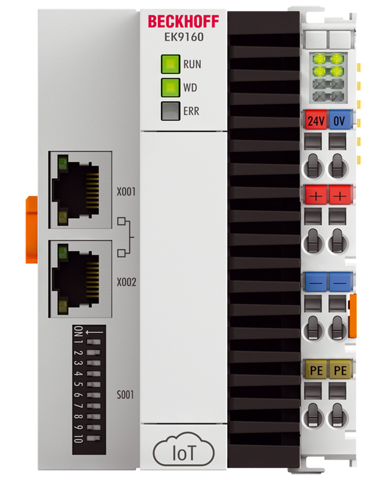

Diagnostic LEDs
Ethernet interface
Interface X001/X002 | Ethernet (EK9160) | Meaning |
LED green | on | Link available/activity |
LED yellow | is not used | - |
LED coupler
Labeling | Meaning | Color | Meaning | |
RUN | Indicates the status of the coupler | Green | Coupler is ready | |
Blue | EK9160 in invalid state. Restart must be carried out. | |||
LED WD | - | Intended for later functions | ||
Err | Color change red -> yellow -> green | Booting the EK9160 | ||
red | flashing | EK9160 in error | ||
LED power supply terminal
Operation with E-bus terminals
Display LED | Description | Meaning |
1 Us 24 V (top left, 1st row) | Supply voltage | on: 24 V connected |
2 Up 24 V (top right, 1st row) | Supply voltage power contacts | on: 24 V connected |
3 L/A (left center, 2nd row) | EtherCAT LED | flashing green: EtherCAT communication active |
