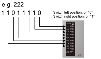

Setting the IP address via DIP switch
The IP address for the switched Ethernet interfaces X001/X002 can be set using the DIP switches S001.
The DIP switches have priority over the settings in the Device Manager. After a change, a reboot must be carried out (open Device Manager => Device => Boot => Reboot).
![]() | Delivery state On delivery, the EK9160 is set to DHCP (DIP switch 9 to "off" and 10 to "on"). When the EK9160 is connected to an Ethernet network, it expects to be assigned an IP address. If there is no DHCP server in the network, a random IP address 192.168.1.xxx is selected. The last byte of the IP address can be set using the DIP switches. |
DIP switch S001 | Meaning |
DIP 1 to 8 all on | The complete IP address is taken from the setting in the web interface (Beckhoff Device Manager) |
9 off and 10 off
| DHCP inactive. By default, the fixed IP address 192.168.1.xxx and the subnet mask 255.255.255.0 are used. The last byte of the IP address 192.168.1.xxx is edited with DIP switches 1 to 8. The first three bytes of the IP address can be changed via the web interface (Beckhoff Device Manager). |
9 off and 10 on | DHCP active. Default setting ex factory. |
