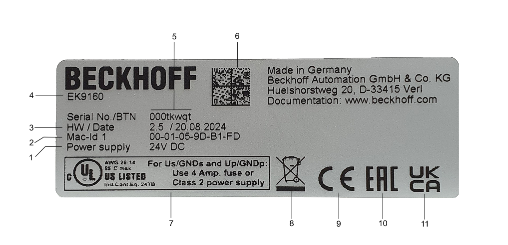

Version identification of EtherCAT devices
Name plate EK9160
Version identification of EtherCAT devices 1:
EK9160 name plate
No.
1
Power supply 24 V DC.
2
MAC addresses of the built-in Ethernet interface.
3
Hardware version and date of manufacture.
4
Product name to identify the coupler.
5
Serial number/Beckhoff Traceability Number (BTN) for the unambiguous identification of the product. The host name is formed based on BTN and the serial number/Beckhoff Traceability Number (BTN). Example: The BTN 000tkwqt results in the host name BTN000tkwqt.
6
BIC (Beckhoff Identification Code)
Machine-readable information in the form of a Data Matrix Code (DMC, code scheme ECC200), which can be used for better identification and management.
7
UL marking with prescribed information on power supply, fuse, temperature, and cable cross-sections.
8
Marking for garbage disposal. Do not dispose of this product with household waste.
9
CE marking
10
EAC marking
11
UKCA marking
