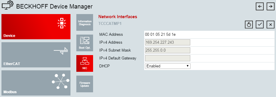

Network-Interface
The network interface enables you to set the IP address. Please note that the DIP switch of the EK9000 takes precedence and its setting applies regardless of what you set in the dialog.
Configuration via the HTML pages of the Bus Coupler 2:
Configuration via HTML pages - network interface
Sample
DIP switch DIP 1 = on; DIP 2..10 off, setting in the dialog 10.1.2.3 -> genuine IP address = 10.1.2.1
(the DIP switch overwrites the last byte of the IP address).
Set the desired IP address and then click on the checkmark.
Note: the old IP address is displayed again in the dialog field since it is still the valid address.
A software reboot is necessary after changing the IP address. To do this, go onto "Boot Opt." and click on "Reboot…".
With the DIP switch setting
the complete 4 bytes of the IP address are accepted from the dialog field.
