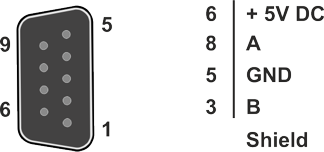

PROFIBUS interface (X001)
PROFIBUS, 9-pin D-sub
Pin 6 transfers 5 VDC, pin 5 transfers GND for the active termination resistor. These must never be used for other functions, as this can lead to destruction of the device.
Pins 3 and 8 transfer the PROFIBUS signals. These must never be swapped over, as this will prevent communication.
PROFIBUS interface (X001) 1:
PROFIBUS, Pin assignment D-Sub
The Profibus bus line is connected via a 9-pin D sub with the following pin assignment:
Pin
Assignment
1
Shielding
2
not used
3
RxD/TxD-P
4
not used
5
GND
6
+5 VDC
7
not used
8
RxD/TxD-N
9
not used
cable colors
PROFIBUS line
D sub
B red
Pin 3
A green
Pin 8
