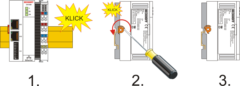

Snapping onto the mounting rail
The Bus Coupler can simply be snapped onto the mounting rail. To this end position the block on the mounting rail and push it slightly until it engages on the right-hand side. This is indicated by a distinct click. Use a screwdriver to push up the lock on the left-hand side, thereby turning it and causing it to engage audibly.
Installation on mounting rails – Bus Coupler 1:
Snapping onto the mounting rail, based on the EK9300 as an example.
Notice
Avoid damage!
Do not force the module or apply excessive pressure!

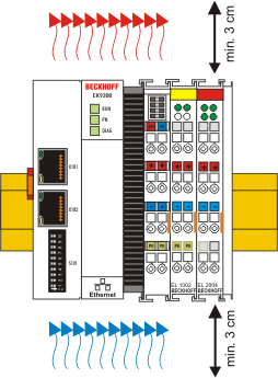

Installation on mounting rails – Bus Coupler 2:
Recommended distances for standard installation position, based on the EK9300 as an example.
Notice
Comply with the permitted installation position and minimum distances!
We recommend the installation in the horizontal position for optimum ventilation. Furthermore, it is not necessary with this installation position to check whether there are terminals present that may only be installed horizontally.
Other installation positions are allowed, but not recommended.

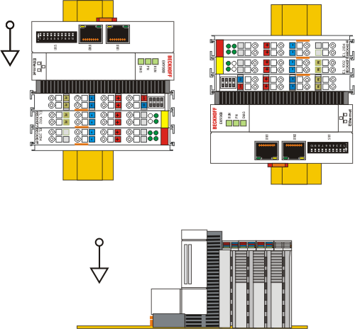

Installation on mounting rails – Bus Coupler 3:
Other installation positions, based on the EK9300 as an example.
