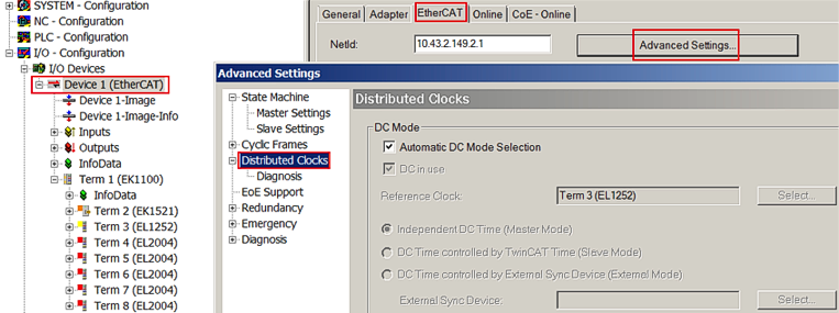

Once of these local clocks is the reference clock, based on which all other clocks are synchronized. See also explanatory notes in the Basic EtherCAT documentation. The reference clock must be the first DC-capable EtherCAT slave. By default TwinCAT therefore selects the first DC-capable device as reference clock. This is shown (and can be modified by the user) under advanced properties of the EtherCAT master. The standard setting should not be changed, except in cases where external synchronization is recommended in the relevant documentation, for example.
Optional distributed clocks support 2:
Advanced Distributed Clocks settings in the EtherCAT master
Fig. Advanced distributed clocks settings in the EtherCAT master illustrates how TwinCAT selects the EL1252 as reference clock by default, since the preceding components do not support DC.

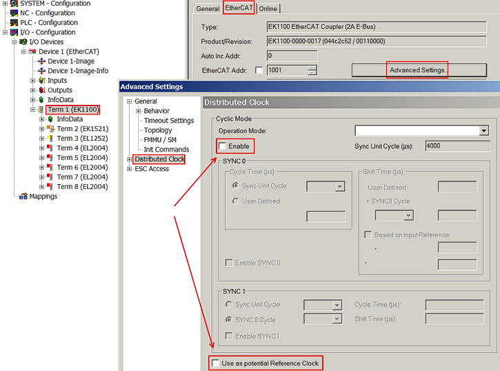

To ensure that TwinCAT uses such a component as DC reference clock, a manual intervention during the configuration setup is required, as shown here using the EK1100 as an example.
The checkboxes “Cyclic Mode Enable” and “Use as potential Reference Clock” must be set.
Optional distributed clocks support 3:
TwinCAT setting for using this component as reference clock
Optional distributed clocks support 4:
Activation of Distributed Clocks support
The (synchronization) procedure described here is only successful for the components described above. The checkboxes can be set for other components, too, although the hardware does not support this function, unless specified in the respective documentation.
