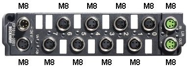

For usage of the EtherCAT connector M8 of EK1110-0008 the following have to be noticed:
M8 connectors
It is recommended to pull the M8 connectors tight with a nut torque of 0.4 Nm. When using the torque control screwdriver ZB8800 is also a max. torque of 0.5 Nm permissible.
Nut torque for connectors 1:
EtherCAT Box with M8 connectors
