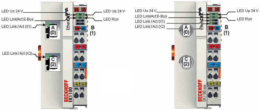

The following figure shows the direction of data flow in a fully connected EK1100 (or EK1100-0008) as an example:
Fig.24: Example: EK1100 / EK1100-0008 EtherCAT coupler with 3 ports The port assignment in the case of the EK1101, EK1501 and EK1501-0010, EK1814 applies accordingly.
Fig.25: Internal and external port assignment for Bus Coupler EK1100 and EK1100-0008 Frame processing sequence
