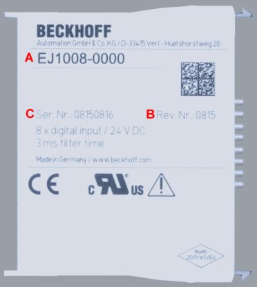

The Order identifier and the revision number are printed on the side of EtherCAT plug-in modules (s. following illustration (A and B).

- The elements mentioned above result in the technical designation. EJ1008-0000-0017 is used in the example below.
 - EJ1008-0000 is the order identifier, in the case of “-0000” usually abbreviated to EJ1008.
 - The revision -0017 shows the technical progress, such as the extension of features with regard to the EtherCAT communication, and is managed by Beckhoff.
In principle, a device with a higher revision can replace a device with a lower revision, unless specified otherwise, e.g. in the documentation.
Associated and synonymous with each revision there is usually a description (ESI, EtherCAT Slave Information) in the form of an XML file, which is available for download from the Beckhoff web site. - The product designation, version and revision are read as decimal numbers, even if they are technically saved in hexadecimal.

The serial number for EtherCAT plug-in modules is usually the 8-digit number printed on the side of the module (see following illustration C). The serial number indicates the configuration in delivery state and therefore refers to a whole production batch, without distinguishing the individual modules of a batch.
