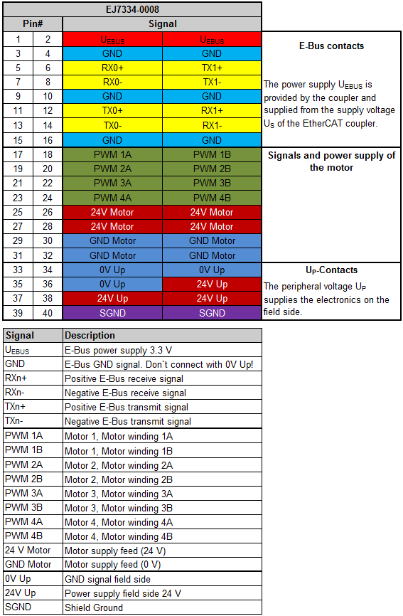

Pinout
The PCB footprint can be downloaded from the Beckhoff homepage
Notice | ||
![]() | Damage to devices possible! Before installation and commissioning read the chapters Installation of EJ modules and Commissioning! |
![]() | Shielding Feedback signal, sensors and actuators should always be connected with shielded, twisted paired wires. |
