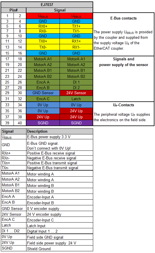

Pinout
The PCB footprint can be downloaded from Beckhoff homepage.
Notice | ||
![]() | Damage to devices possible! Before installation and commissioning read the chapters Installation of EJ modules and Commissioning! | |
![]() | Shielding Feedback signal, sensors and actuators should always be connected with shielded, twisted paired wires. |
